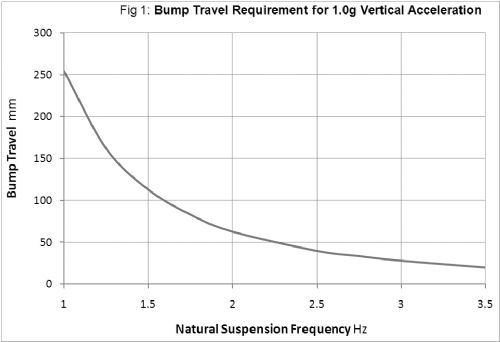

Posted: 23 October 2017 at 2:03pm |
Here is a graph I made for and article on suspension I wrote which might be useful:

The reason I have advised using a higher spring frequency for your trike than for a saloon car is that it is more difficult to have a system that doesn't absorb your pedal power if the suspension is very soft. 2.5 Hz should give you a noticeable suspension effect while avoiding these problems. A traditional racing car would have suspension frequencies in the 2-2.5 Hz range. Modern race cars use harder suspension because they have to resist aerodynamic downforce.
Mountain bikes have hard springs and lots of travel because they are designed to absorb 2g (or more) bumps. I find MTB suspension fairly useless on the road as it is too stiff. Edited by GeoffBird - 23 October 2017 at 2:17pm |
