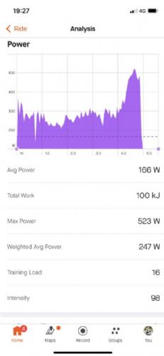

Post Options Post Options   Thanks (0) Thanks(0)   Quote russellbridge Quote  Post ReplyReply Direct Link To This Post Posted: 16 September 2022 at 6:26pm
Any thoughts from the hive mind on power vs speed vs timing on my last two runs?
Need to find another 4mph somewhere
Can someone turn that into a clicky link please
https://www.strava.com/activities/7817892428

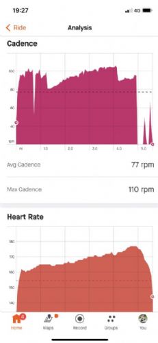

Post Options Post Options   Thanks (0) Thanks(0)   Quote atlas_shrugged Quote  Post ReplyReply Direct Link To This Post Posted: 17 September 2022 at 8:27pm
Speed Power Cadence for Russell
Post Options Post Options   Thanks (0) Thanks(0)   Quote atlas_shrugged Quote  Post ReplyReply Direct Link To This Post Posted: 18 September 2022 at 12:01am
Why the slight drop in power but slight increase in cadence just before the 5 mile mark?
