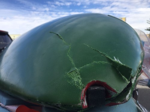

Soup Dragon update: collected - with some pretty ugly heavy damage - from Reno this morning and currently on its way up I-80.  Master fettlers Steve Nash and George Leone have been roped in to help fix it and Russ hopes to qualify it tomorrow morning.

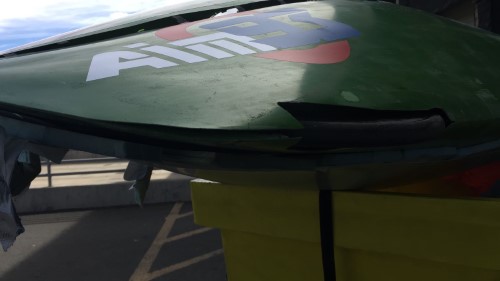

Good news: we have the bike
Bad news: it's damaged
Barney and Jo are driving it back from Reno now so we don't know the full extent of the damage yet.
However, we've very kindly been offered help by the amazing people out here, in particular Steve Nash, George Leone and Barkley (sp?) Henry. Glen is currently formulating a plan for repair based upon the photos. If we can get it fixed this afternoon, I then need to test ride it (hopefully with the lid on), then we need to get it tech inspected, then I need to qualify (min 45mph) on the 2.5mile course tomorrow at 8am. Cue A-team music...
3 photos below. It looks bad, but not giving up yet.
Edit: post overlap with Dave, obvs his t'internet is faster than my t'internet.
ps I did another 2.5mile run in the Milan velo this morning and got a wind-legal 55.4mph, which gets me a shiny new hat. I've offered my place in the evening 5-mile run to Ken on the Liverpool hand cycle team as they're close to breaking a record and I'm just arsing about in a borrowed velo...
Edited by russellbridge - 12 September 2018 at 9:09pm

How the hell did they manage to do that to the Soup Dragon???
Good that the Soup Dragon has turned up so not a total remake!
I thought a standard system run alongside the VR one would be OK? So just pull the VR headset off and look at the standard monitor. Seeing those guys flying at 100 mph makes me think a crash would be less likely with the VR System. Only one way to find out.Wink
Lets hope the Soup Dragon is more fixable than it looks.
Post Options Post Options   Thanks (0) Thanks(0)   Quote GeoffBird Quote  Post ReplyReply Direct Link To This Post Posted: 13 September 2018 at 12:09am
Sad to see the Soup Dragon in that state Russ - hope you get it fixed in time.
I'm sure there are guys there with lots of experience of fixing things like this, but in my experience, what you need to do is firstly get the bits as close as possible to the original shape - use gaffa tape, hot glue gun and splints, screws, whatever it takes, all on the outside, but it will save you time (and weight!) later the closer you get to the desired shape. Then key up and fibreglass over the inside surface - use polyester - it's quicker and less fickle. If you are skilful with the amount of catalyst then you can get it to cure in an hour without overheating/distorting. Now, remove the external support and cut back the original glass-fibre, grinding deep into the cracks and leaving nothing protruding from the desired form - better to grind off too much than too little and remove anything loose. An angle grinder with an abrasive wheel is quickest but makes a hell of a mess and wear a good P3 mask! Now fill with Bondo (as they say in the USA). Don't be tempted to put too much on at once - it takes a long time to take off again. Initially use a coarse Al oxide paper - maybe 40 grit (or even a Surform or, my favourite, a dreadnought file) as this will shape the filler, rather than just smoothing the surface of the irregularities. Back the abrasive paper with something fairly firm, not soft foam or it won't take off the high spots - you are shaping at this stage, not smoothing! Once you have the shape, you can get a smooth surface in the time remaining. A high-build spray filler works well at this stage. Hope that helps a bit.
