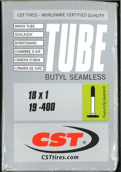

Joined: 14 March 2005 Location: Hornsea, UK Status: Offline Points: 2433 |
Posted: 23 August 2012 at 2:03pm |
So they do exist and arrived today:
![]() These appear variously as Primo, Kenda, XLR and CST (Cheng Shin Tires), which are very probably all the same company. As they are vanishingly hard to get hold of, and no longer listed on the CST website, I strongly suspect they aren't made any more. Now to see how well they fit the 23-406 Ultremo. |
