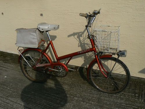

Cheers, Ive had a practice on all my junk.. trying to build a 'learning curve' bike for dirt cheap!
Stranger things have happened!

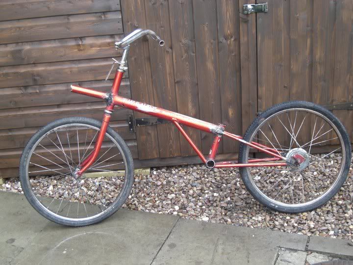

This is going to be my TEST bike
This will be my TEST bike... YOU THINK IM MAD RIGHT???
Posted By: Shiner
Date Posted: 04 April 2011 at 9:25pm
SO FAR.... SO GOOD
Did a wee bit of chop and weld.. going to attach a BMX crank to the front tomorrow..
Posted By: Shiner
Date Posted: 04 April 2011 at 9:26pm
PS.. Handlebars are not staying.. there going to go under slung

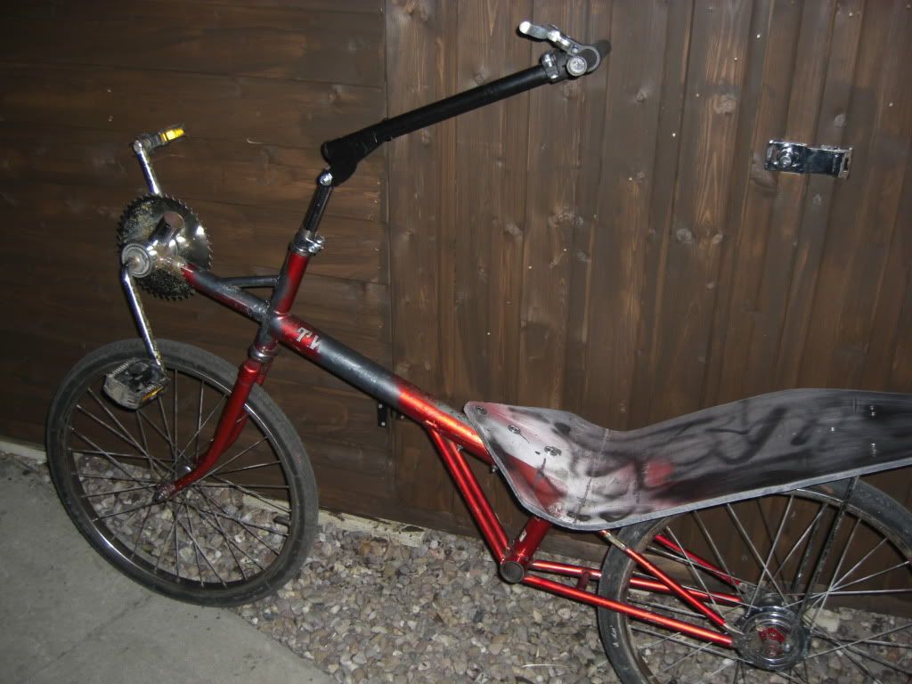

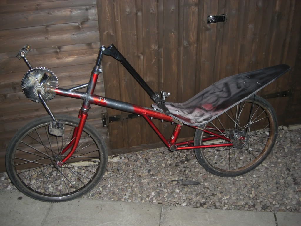

Date Posted: 07 April 2011 at 4:10pm
SEAT BASE DONE!!! NOW I NEED TO MAKE SOME HANDLE BARS!! (ones showen are for wheeling arround the yard)
Then I need to put on chain, brakes and gear switch, and Im away!!!!
Onece finished, Ill strip it all down and paint / polish it up... Then we can think about aerodynamics!
Paul

Excellent! Thumbs Up That's a pretty extreme seat angle!
So you'll be wanting a race number for Hillingdon then??....

I would make sure that you are able to see over, around or through the front end of your bike, with you seat so reclined you may struggle to see the track or road in front of you, this may also make for a very sore and tired neck with out a neck or head rest to support you.
Have you tried lying on the bike in a riding position to check the seating position? you may find it easier to ride (at first) a little less layed back. on the plus side though it will be a very aero position (so long as the blood does not all drain to your head) LOL
If you have never riden a recumbent before it may also be wise to be aware of the crank, pedal, foot interference with the wheel, it is not so much a problem when riding normally, but can cause problems if going slow and turning tightly whilst still pedalling, the first time it happens can be very un-nerving if not aware of it; and an abrupt stop or loss of balance followed by cursing can be side effects of it.

Great work Shiner.  With that seat back angle you will certainly need a headrest or a comfy neckrest.  The rules don't require it, but a mirror is very useful.  Take a Look is good for spectacle/shade wearers.  Blackburn and Third Eye also.  On-bike options include Mountain Mirricle and Busch+Muller (B&M) models.

JUST SHOWING YOU HOW THE ACTUAL STEERING WORKS ON A PIVOT!
THANKS FOR ALL THE SUPPORT GUYS!!!
LOL @ BAZ... You are right I am nearly finished...
Ive taken into account about the pedals making contact when steering sharply.. Its something ill have to get used to on my quiet road...
And I am currently in the prosess of making a nice headrest so I dont have to see the sky all day!
Thanks again, Paul!

Posted By: Shiner
Date Posted: 09 April 2011 at 5:15pm
Pully arrived yesterday Thanks Geoff... Chains on and the bike rides, the problem is the riders not used to it.... lol.. Ive started on making a neck support now so I dont end up in A&E with my head stuck looking down!!
Seeing its a nice day. And my bike goes forwards.. Ive decided to give it a splash of colour ''what I found under the sink!'' as Im penny pinching with this prototype...
Tomorrow I will re build, and start putting the brakes and 3 speed back together..
Then finish said headrest, change the pedals and pad the seat... Don't let me forget ''chain guard''
DONE in a week... BISH BASH BOSH!!!
Posted By: Shiner
Date Posted: 10 April 2011 at 6:02pm
A FEW PICS OF THE FINISHED ARTICLE... OR IF YOU LIKE VIDEOS???? ILL UPLOAD ONE IN A SEC
THERES STILL A BIT MORE PULLY AND CAIN WORK TO BE DONE TO MAKE IT SAFER.. BUT IT WORKS!

Posted By: Shiner
Date Posted: 10 April 2011 at 8:38pm
One week exactly! thanks all again.. the red paint and skull stickers were found under the sink, I basicly used what I could lay my hands on!
Few issues to address.. I need another pulley (smaller one) to lift the chain off the forks, and get my 3 speed hub all wirded up so I can used 2nd and 3rd and test it at some real speed!!
So its not technicaly its not quite finished.. I cant wait untill its 'road safe' and I can really see what it can do...
{Did any of you spot a change?}
I had to raise the seating possition as the wheel base is so short, there was no weight over the front and it just fell over at the slighest wobble! Raised seat.. sorted!
Paul H
