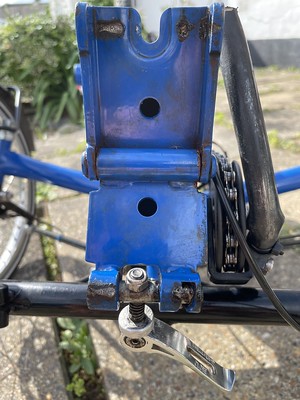

Seeing the hinge open it lacks any contact on the side tabs, but ironically a rubber patch right across the lower half might resist torsion a bit (done up hard)

The problem is that the hinge pivot pin is a loose fit longitudinally and laterally. Torsionally, the two hinge plate rotate around the QR clamping point, regardless of how tight the QR is. You can see the gap on one side. I think reducing the lateral movement at the hinge pivot pin would mostly solve the problem.

A friend has agreed to try remanufacturing the frame hinge with an oversize hinge pivot pin, as recommended by Pacific Cycles, the GT3 frame’s fabricator. Hopefully that will solve this recumbent’s last major issue.
